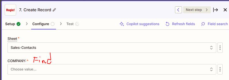

I am having a hard time with Ragic <> Zapier integration because Zapier doesn’t support a “find record”
Many of my best workflows would be a user story like the below:
"find “a company” in “my Ragic contacts” based on email or phone number… then CREATE a record.
  • Is it hard to create this zapier “Find” feature?

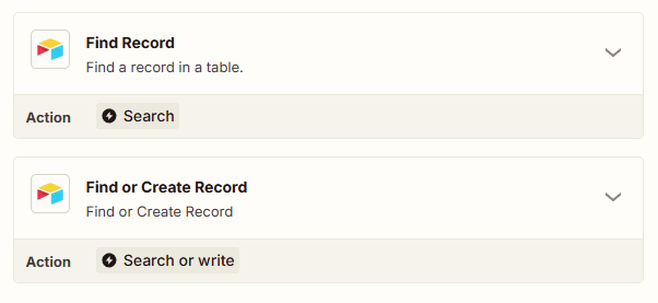

see below – Airtable supports this. Is anyone familiar with How i can achieve this in the current Zapier world?
Any ideas?

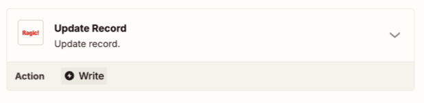

To clarify, the current “Update Record” action in Ragic’s Zapier integration works as follows:
Update an existing record in Ragic if a match is found using the specified key value.
If no match is found, a new record will be created.
With that in mind, the workflow you described can be supported using the existing “Update Record” action:
  • Trigger: a Zap from an email (another app (e.g., Zapier),
  • Action: Add a step to “Update Record” in Ragic. This will search your “Contacts” sheet using the email address as the key value. If a match is found, the record will be updated; if not, a new contact will be created.
In this case, the email address serves as the unique key to identify whether a contact already exists in your Ragic sheet.
We recognize that the current description for our “Update Record” action in Zapier isn’t very clear, and we’ll work on improving it. Thanks for pointing that out!

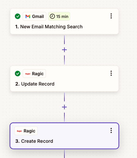

To support this, you can add a second step in your Zap after the “Update Record”:
  • Use the “Create Record” action to create the related “RFQ” record in Ragic.
  • Pass along the necessary information from the previous step (updating or creating Contact) to create a related “RFQ” record in Ragic
I hope this helps! Let me know if you need any further clarification.

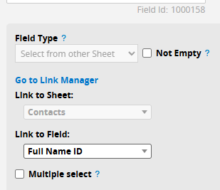

Thank you – but this does not solve my issue…
I need the API / Zapier integration to search for an email, and return the “full name ID field”
Because this is my Key field in my other Ragic sheet that i must populate… (Jobs)
that is why i was wondering if i can “search” for a record like airtables integration, which would like me find a record and pull any related information from that record.
does this make sense?

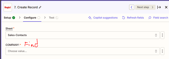

Yes the below workflow is accurate:
  1. Trigger a Zap from an external app (e.g., email, Google Sheets, etc.)
  2. Search the Ragic “Contacts” sheet for a contact by email
  3. If match is found, Retrieve the Full Name ID from the matched Contact
  4. If no match is found, create a new contact, Retrieve the Full Name ID from the new contact
  5. Use that ID to create a related record (e.g., Job) in another Ragic sheet
would something like this require customer API?
Last, the Full Name ID is a concatenated text field that is unique = (First Name + Last Name + | Autogenerated #)
example: Jonathon Warren | P-05627
Hi Matt,
Thank you again for your patience over the past few days.
We’ve taken time to thoroughly test and review your request internally to ensure we could give you a clear and accurate answer. After careful evaluation, we can confirm that the Find feature is not currently supported in our Zapier integration.
That said, I’ve added you to our notification list, and we’ll be sure to update you here as soon as this functionality becomes available.
In the meantime, you might consider building your own integration using the Ragic HTTP API. If you have any questions during implementation, feel free to contact us at support@ragic.com — our development team will be glad to assist.
Thanks again for your understanding and detailed feedback — it’s been extremely helpful in identifying future improvements.

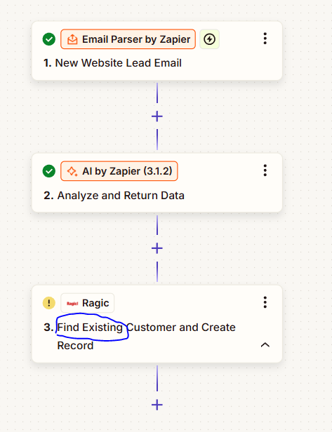

@katet Katie and @jeff_kuo

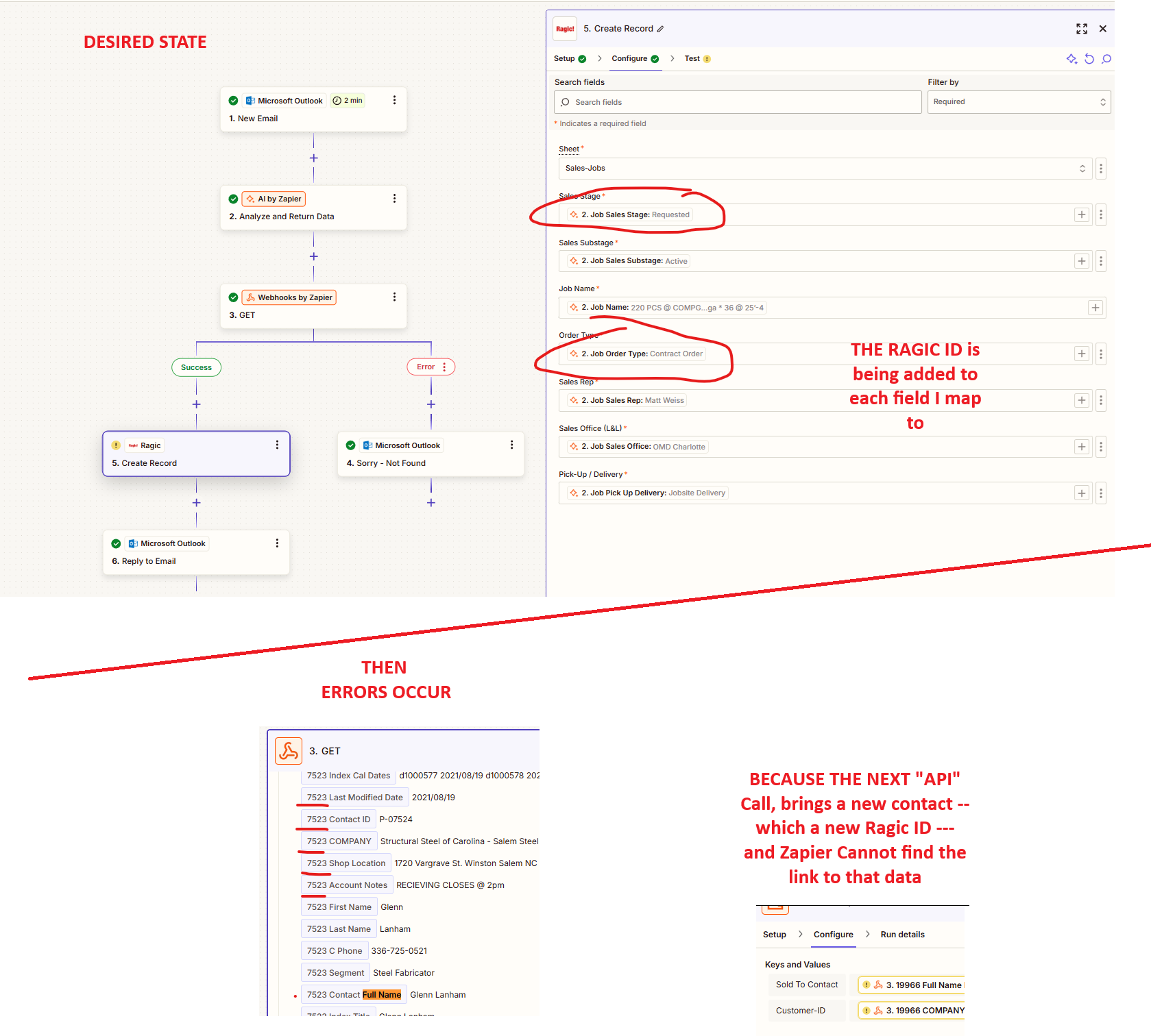

  • As a Sales Person , I want an AI agent to:
    • Analyze a forwarded customer email
    • Check Ragic CRM for existing customer record by email
    • If record exists, parse email to extract details (job details, quantities, dates)
    • Create new “job” record in Ragic using Ragic API “GET” Company-ID and Contact-ID
    • Return job record URL for review and confirmation
Zapier is failing because the Ragic ID is being passed through as a prefix to ALL fields, so while my initial test runs work, as soon as i publish and send a new email, a new Ragic ID is passed, and the zap fails… can you suggest any workarounds for this so we can maintain automation in Zapier?
Hi Matt,
Thank you for sharing your current build with us. If I’m understanding correctly, it looks like you’ve taken our previous suggestion and are now working with the Ragic API to create new “Job” records. It sounds like the current issue is that after the API creates a new record, a new Ragic ID is being passed through as a prefix to all fields, which is causing the Zap to fail.
Since this issue relates to a custom API implementation, our development team would be best positioned to assist. Could you kindly reach out to us at support@ragic.com with the details? This will help us coordinate more efficiently and provide you with the most accurate support.
Thank you again!
