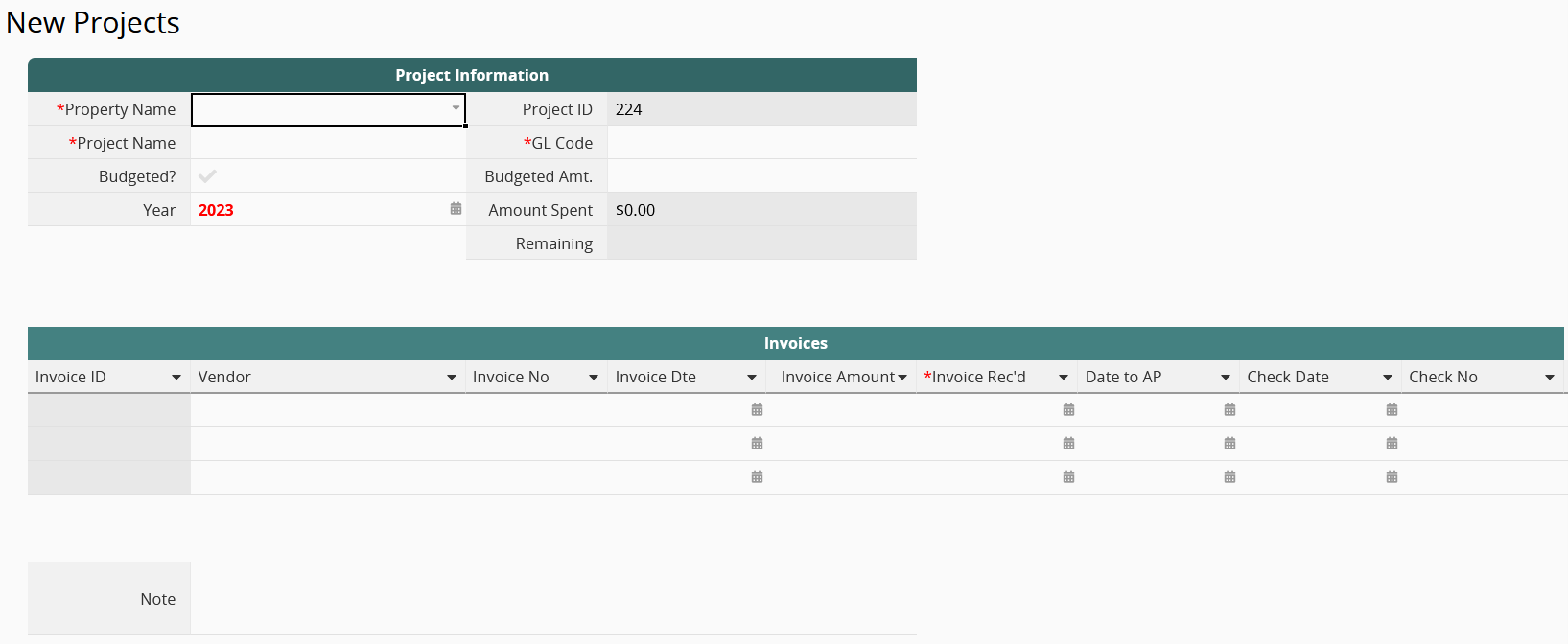

I have a two table database. The main table contains the project information and the sub-table contains the invoices for that project. What I want is when I go to enter a Vendor in the sub-table I will see a list of vendors already in the system (so I can standardize how the vendor name is entered). This could be a drop down list or preferably a type-ahead field that would narrow the possible responses based on what it typed.
Is this possible and if so how do I accomplish it?

The Project information record does not contain any vendor related info. It is linked to a subtable for that project that contains the details of each invoice to complete the project. There could be many vendors for a single project. What I want is someway to ensure that the Vendor Name is always entered the same way (ie spelling, abbreviations, LLC, Inc, etc). So that “N & S Pools” doesn’t get entered as “N and S Pool” which would not be the same in a search.
Not sure how I missed it but the Select option for the field is almost perfect. Question, when I add a new vendor to the list it is at the bottom of the list. Other than opening up the Design window and sorting the list again is there anyway to auto-sort the list of choices when a new choice is added?

I guess I’m a little confused. I understand link & load for pulling multiple fields from one table into another but in this case it’s just the vendor name. So would I create a new table with the vendor names then link that field to the data entry vendor name in the other table? When entering a vendor in the “original” table it would reference the new vendor name table and display vendors based on what I had typed? Would it add new vendors to the vendor list automatically or would I have to first enter them in the vendor tabIe? have that now with the Select from list, except for the sorting of new vendors. Do I have that right?
