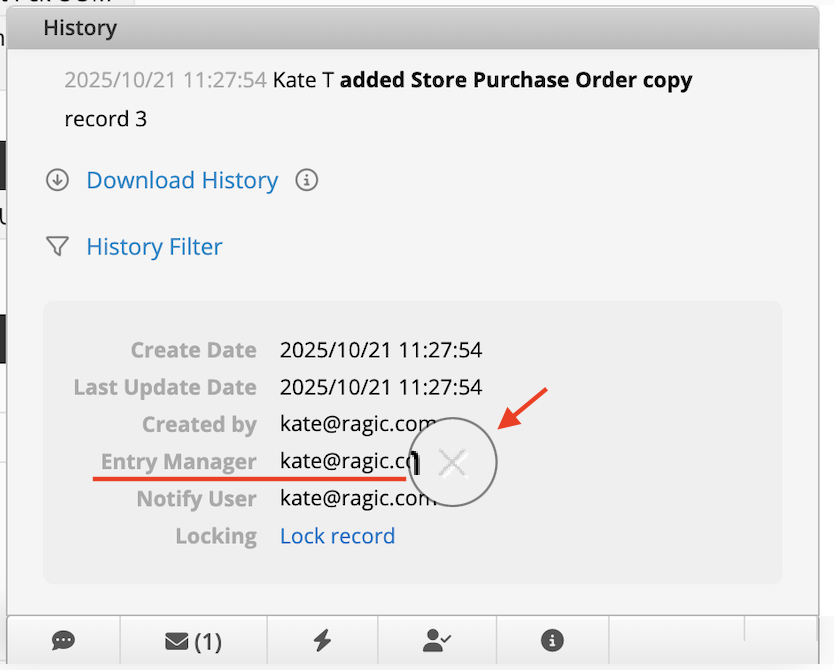

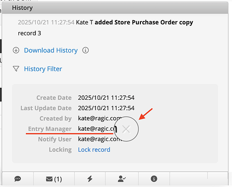

  • If the user originally created the record (method 1), the only way to remove their Entry Manager label is manually — through the information (“i”) panel on the record, or by batch removal. You can find detailed steps on how to remove Entry Managers here.
