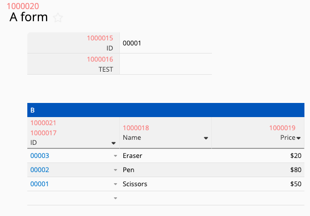

Step 1: In Form A, the subtable links to records in Form B.

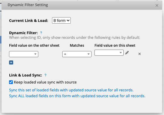

Step 2: In Form A’s Link & Load settings, the “Keep loaded value sync with source” option is selected.

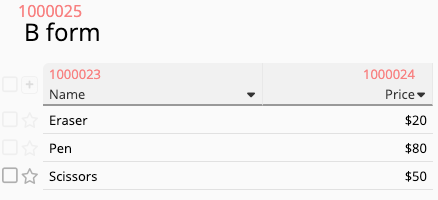

Step 3: The design of Form B.

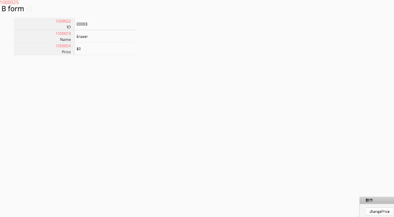

Step 4: A action button named ChangePrice is created.
Step 5: Executing the action button sets the Price field of a specific record to 0.

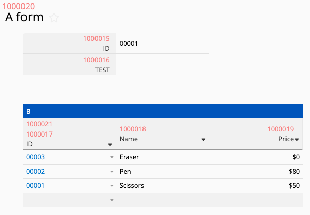

Step 6: The linked data in Form A is updated accordingly.
