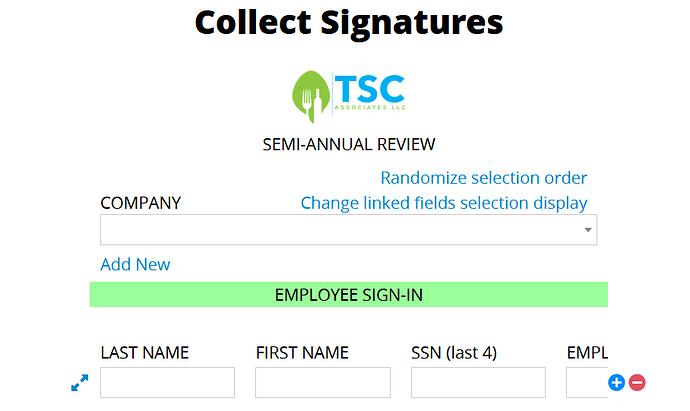

Need a public (EVERYONE) sign-in form where users select a company from a drop-down menu, and then sign their signature against employee list of names that exist in a sub-table on another sheet. We do not want to duplicate employee rows or require login. Is there any supported way to expose sub-table rows to public users for selection and editing?
The sign-in form the employee has access to should work like this:
  1. Select their Company from a drop-down menu (which then pulls a list of all the employees for that company, which is in a sub-table on another sheet);
  2. The employee locates their name from the list.
  3. The employee taps in the signature field next to their name and signs their name.
  4. Once the sign-in form is submitted, the signature updates in the sub-table in the Ragic sheet.
Currently, there’s no way to link & load info from sub-tables. Is there a remedy to how to create such a sign-in sheet?

Hi, Kate! I’m so close to getting this to behave as I want. The issue I’m running into now is, on the “Sign-In” sheet that the employees will have access to (remember, they will select which store/branch where they work, and then the Sign-In sheet will auto-populate all of the employees from that store/branch; the employee will locate their name and then sign next to it), as you can see from the screenshot of the public/everyone Sign-In sheet, it only populates one employee on only one row. If I share the “raw URL”, then they can see every employee after selecting which store/branch where they work - but this isn’t as “clean” of a format, especially on mobile devices, which is what most employees will be using to sign-in.
Is there something I’m missing for when I share the Data Collection URL? Maybe I need to set it up to where the employee 1) selects their store/branch, then 2) they will need to select their name from a dropdown, too?

Hi Chad,
Thank you for sharing that screenshot; it helps pinpoint exactly where the workflow is hitting a snag. It appears there is a misunderstanding regarding how Ragic handles subtable populations for new entries. We would like to take a step back and point out a significant disconnect: while Ragic supports selecting a branch to auto-populate a list of employees, we do not recommend using this specific feature for a “create new record” workflow.
The reason for this is data integrity. Even if an employee only signs next to their own name, the system must still store every other employee name in that subtable for that specific submission. Because the system cannot automatically clear rows where signatures are left blank, this process would quickly fill your database with thousands of redundant, empty rows.
In the screenshot provided, it appears you are using the web-embed tool to have each user “create a new entry” that pulls the full employee list into the subtable every time. To avoid the redundant data issue while still providing the “clean” mobile experience you are looking for, we suggest steering away from the subtable display and instead using a Dynamic Filtering approach.
