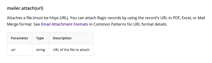

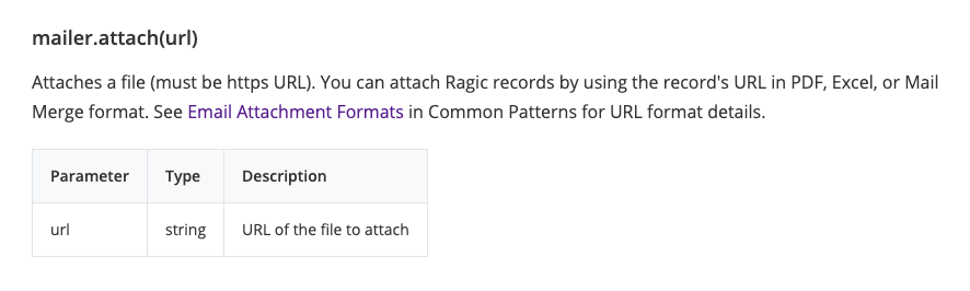

Can’t we send a pdf in the attachment?
You can refer to Ragic Workflow Engine Documentation — specifically the section about mailer.attach(url), where you’ll find how to convert a form into a PDF.
If you need to attach other files, simply enter the URL of that file.
