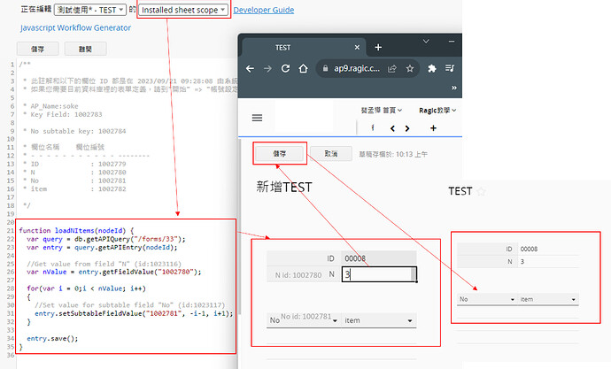

Sorry, I didn’t explain it clearly. The above part is generated from “Javascript Workflow Generator” and I am modifying it.
The field “1002373” in the main table is a numerical value. After getting this ‘N’ value, add an ‘N’ pen subtable.
And sort the pen data from “1” to “N” in the serial number field “1002374”,

you can try something like this to fill in No. 1~3 in subtable, if the N = 3.
function loadNItems(nodeId) {
  var query = db.getAPIQuery("/devtest/15");
  //Get value from field "N" (id:1023116)
  var nValue = entry.getFieldValue("1023116");
  for(var i = 0;i < nValue; i++)
    //Set value for subtable field "No" (id:1023117)
    entry.setSubtableFieldValue("1023117", -i-1, i+1);
  entry.save();

But I don’t know where I am doing wrong.
Can you take a look at it for me? I pressed save and it didn’t automatically say 1…2…3…
Did you use loadNItems({id}) in the JS Action button?
Thank you very much!! I added the button and it worked successfully after clicking it
