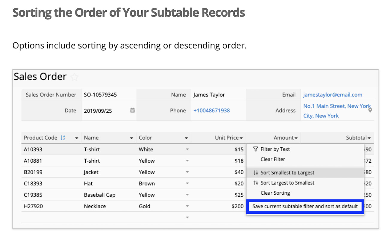

In the meantime, you can try the following workaround to arrange the order of subtable lines:
  1. Add a “Number” field to your subtable and use it as a sequence number, which you can manually assign and adjust as needed.
  2. When viewing subtables, sort the records by this sequence field. In the subtable’s sorting dropdown, you can also select “Ssave current subtable filter and sort as default.” This way, the same sorting order will be applied by default the next time you view the form.
Hope this helps! Feel free to let us know if there’s any further questions.
