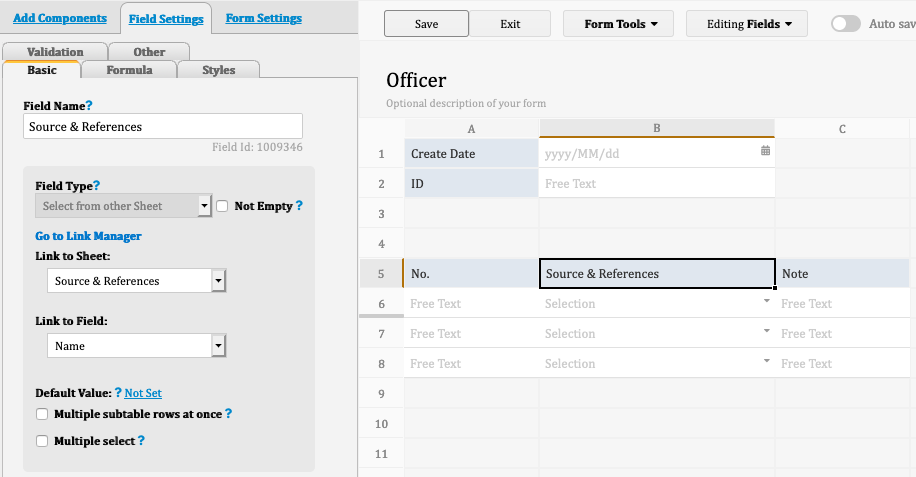

Step 1. Create an “Officer” sheet which contains a subtable.
For example:
%E5%9C%96%E7%89%87
Step 2. Create a “Source & References” sheet
For example:
%E5%9C%96%E7%89%87
Step 3. In the “Officer” sheet, please use link & load to link the “Source & References” field to the " Source & References" sheet.
Step 4. In the “Officer” sheet, use new sheet from subtable to create a new sheet. Let’s call this sheet “Officer to Source” in the below steps.
Step 5. In the “Source & References” sheet, please use show references from existing sheets to insert the “Officer to Source” sheet as a subtable.
This method could be applied when you would like to manage different sources within a subtable in your “Officer” sheet. You may test this structure under the “Community” tab in this database.
