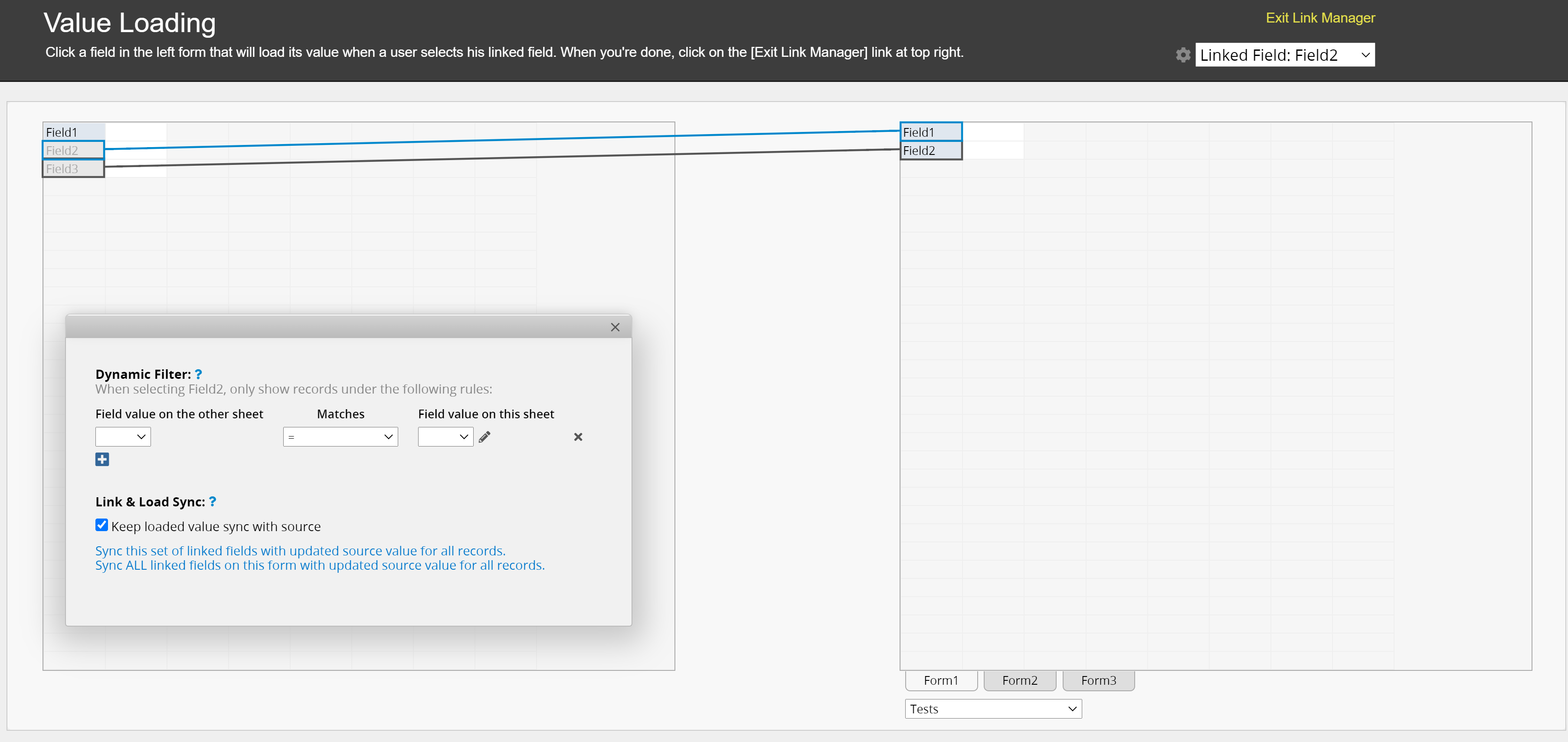

We are having same issue. It seems that keep loaded value sync with source doesn’t work properly when the source value has been changed/loaded by other sync process. In other words, it seems that sync doesn’t work in cascade, just works at first level.
Form2 Link Manager:
Form3 Link Manager:
Form1 Values: (We changed Field2 from Value#01 to Value#001)
Form 2 Values: Field 3 Sync OK.
Form 3 Values: Field 3 Sync NO OK.

Hi,
I’ve just tested applying consecutive link and load relationships on three sheets (sheet 1 linked to sheet 2, sheet 2 linked to sheet 3) and have keep loaded value sync with source enabled on all link and load relationships. In this case, when I manually updated a loaded source field in sheet 3, the respective value was also updated in the loaded field in sheet 1.
Could you all please check if it is working properly? If not, please describe the linking relationships and how was the values modified so I can take a further look.
