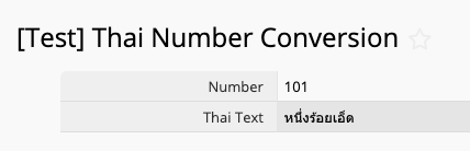

Thanks! I tried it, but it somehow didn’t really run.
When a record was saved, there was a modal window saying that the entry was saved, but then it stayed like that. The modal froze and didn’t go away as normal. The log (thank Ragic for that compared to that-which-must-not-be-named) didn’t show anything besides the updated number field, not even the log.println() stuff.
This also happened on my version as well, when let and const are changed to var. Did I mess up something?
Is it related to my account being a trial account? If so, I’ll do this later when I finally subscribe (in a few days).
Edit: just found the workflow execution log. Silly me. It says it found EOF. I’ll double check.
The code ran fine on my end though.
But I currently put that all in the post workflow on my test form.
It’s able to generate the result.
Not sure what cause you the EOF error.
