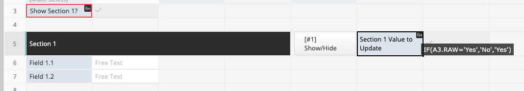

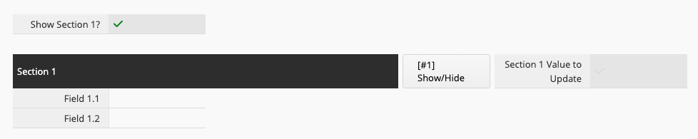

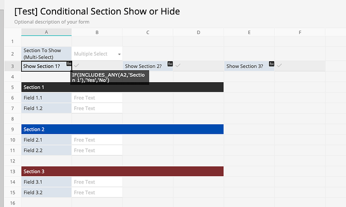

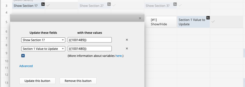

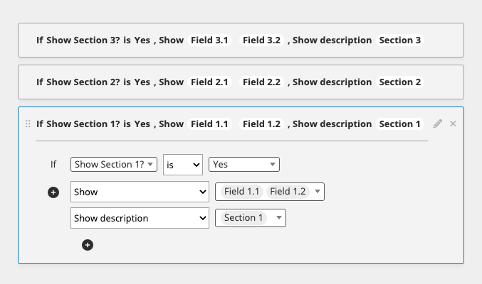

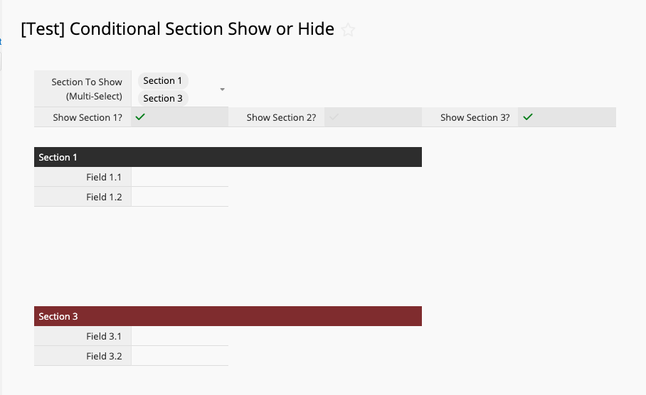

Not sure if I fully understand what you want to display. But in terms of determine whether a certain section need to be displayed.
You can do something like this and use Conditional Formatting to control it with either “Show/Hide” “Show Description/Hide Description” “Show Section/Hide Section” as you like:

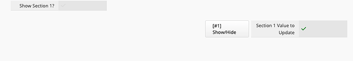

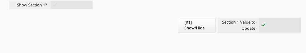

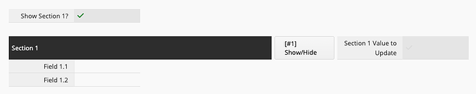

To control with the Same Button to Turn On/Off:
You can create a field that is always generating opposite value for updating the Control field.
Then you can use the same button to control Show/Hide.
